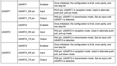

2025-12-24 12:47 AM
Hello @pavelkotel
to enter the STM32H573 system bootloader using hardware (as described in AN2606):
This will make the microcontroller start from the system memory bootloader instead of your application.
Then, connect the board to your host using one of the USART interfaces shown in the figure (USART1,USART2 or USART3, depending on your hardware).
you can also use STM32CubeProgrammer and select the appropriate USART interface when connecting to the board for firmware update.
