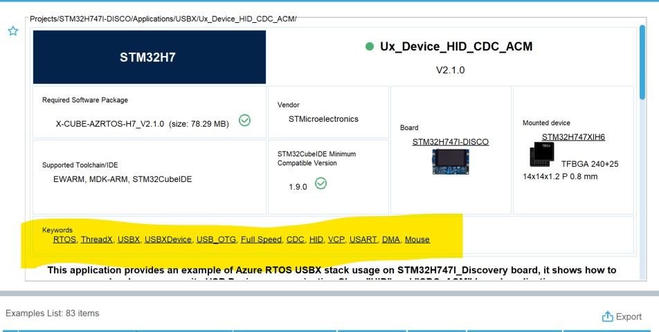

Dear @mohamed.ayed
Thank you for you comment. You are indeed right about that particular example.
I didn't notice it before because it is wrongly labeled as "Full Speed" in Cube.
Using this example I will try to get USBX HS Ext PHY to work on my project. Will post an update when I succeed (or fail :p ).
