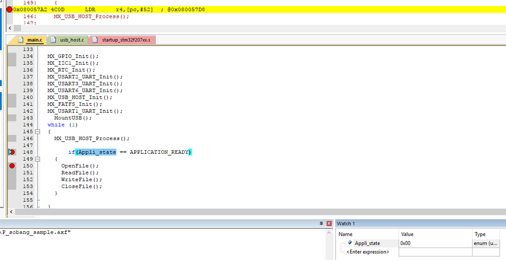

We are testing usbh mass storage using the nucleo_f207zg board.

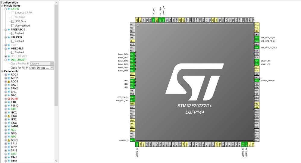

STM32Cube_FW_F2_V1.7.0 \ Projects \ STM32F207ZG-Nucleo \ Applications \ FatFs \ FatFs_USBDisk received from the homepage is detected without any problem.However, I created it directly as a cube (attached file) -> I tested another sample,
I can not find usb. Debugging shows that the appli_state value is still 0x00.Does the nucleo board have characteristics? I want to solve this problem by all means.

I attached the main / usb_host / cube file and image capture image below.
Please help me. =) Have a good day!
main.c
void MountUSB(void)
{ res = f_mount(&USBDISKFatFs, USBHPath, 0);// if(res != FR_OK) // DisplayError(); }void UnMountUSB(void){ res = f_mount(NULL, '''', 0); // if(res != FR_OK) // DisplayError();}void OpenFile(){ res = f_open(&MyFile, ''123.txt'', FA_WRITE|FA_READ);// if(res != FR_OK)// DisplayError(); }void CloseFile(){ res = f_close(&MyFile);// if(res != FR_OK)// DisplayError();}void ReadFile(void){ res = f_read(&MyFile, text, sizeof(text), (void*)&bytesRead);// if(res != FR_OK || bytesRead == 0)// DisplayError(); }void WriteFile(void){ //Increase Number int16_t number = atoi((char const*)text); number++; memset(text, 0, sizeof(text)); sprintf((char *)text, ''%d'', number); //Move cursor res = f_lseek(&MyFile, 0);// if(res != FR_OK)// DisplayError(); //Write Number int16_t len = strlen((char const *)text); res = f_write(&MyFile, text, len, (void*)&bytesWritten);// if(res != FR_OK || bytesWritten == 0)// DisplayError();}int main(void)
{ HAL_Init(); SystemClock_Config(); MX_GPIO_Init(); MX_I2C1_Init(); MX_RTC_Init(); MX_USART2_UART_Init(); MX_USART3_UART_Init(); MX_USART6_UART_Init(); MX_USB_HOST_Init(); MX_FATFS_Init(); MX_USART1_UART_Init(); MountUSB(); while (1) { MX_USB_HOST_Process(); if(Appli_state == APPLICATION_READY) { OpenFile(); ReadFile(); WriteFile(); CloseFile(); } }}usb_host.c
