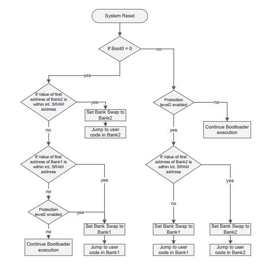

As per my understanding so far (after going through AN2606), bootloader looks for code validity on the flash bank (both 1 & 2) and jumps back to flash code if the flash code is valid. because of this dual bank mechanism control immediately switches bank to bank 1 as it has valid code.
I am looking a way to that make system bootloder to continue its execution even if it finds the valid code on the flash bank when BOOT0 pins is tied to low.
Here is the snapshot of dual bank boot mechanism from AN2606 for STM32L073XX

I think it's not a good idea to read back ROM bootloader code to determine entry point as it is subjected to change over time and part revisions. I needed bootloader source code so that I can customize and use it to minimize my effort.
But I am just wondering what is the use embedded ROM bootloader when there is no software mechanism to switch to boot from user application?
2017-07-24 9:36 AM
It's designed to allow simple programming of parts with no code on them in a production, or bricked-in-field situations.
Pretty sure I can trivially enter the loader from software, problem is having it do something different than coded in the ROM.
If you need to uses the dual banking, a short loader copied in both locations could easily fork and manage which image is used.
