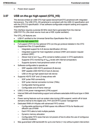

Would you attach your IOC file? Based on the datasheet, STM32U5G embeds HS PHY internally. Why would you configure it with 60MHz?
