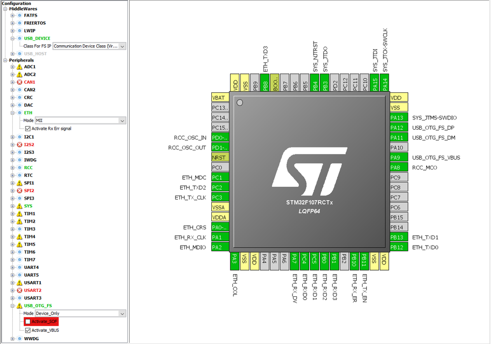

I want to make a bridge from USB to Ethernet, to give connectivity to a tablet.
I am using an STM32F107RC, a DP83848CVV phyter and the CubeMX to generate the code with this configuration:I do not know how to link it, should I share a buffer or something?
It's the first time I've touched Ethernet and I'm a little lost, besides that I don't see anyone who has done something like this before.Thank you very much!#connectivity-usb #ethernet #stm32f1072017-01-24 4:52 AM

Hello
Bhatia.Kumar
, thanks for your reply. I have the hardware mounted this way, and I use this micro only for that besides an STM32F103 for RS232 / 485 communication. In this boardI also have two ports to connect USB. At the moment it would discard the idea of putting another dedicated micro, sincethis implies make another PCB. Would it be easier to buy a USB adapter to ethernet already mounted and connect it to the USB port? What I save on the 107 is equated with the cost of the new device. Is this reliable? It is for an industrial application.Thank you very much.

Hello
Bhatia.Kumar
, thank you again for your answer and your time! 1) The project is based on USB2.0 FS 2) I am using several USBLC6-2 on each USB HUB port and TVS diodes on serial communication outputs (RS232/485/422). And yes, the tablet will be the host with windows The idea is to have a single device that can be connected to Ethernet or RS232/485/422, but independently and definitively. That is to say, a multipurpose board, but that will be used only for one typecommunication, depending on the machine to which it will be destined.I have at my disposal a network adapter with the AX88772A, I will try it with my board to know if it is compatible.
