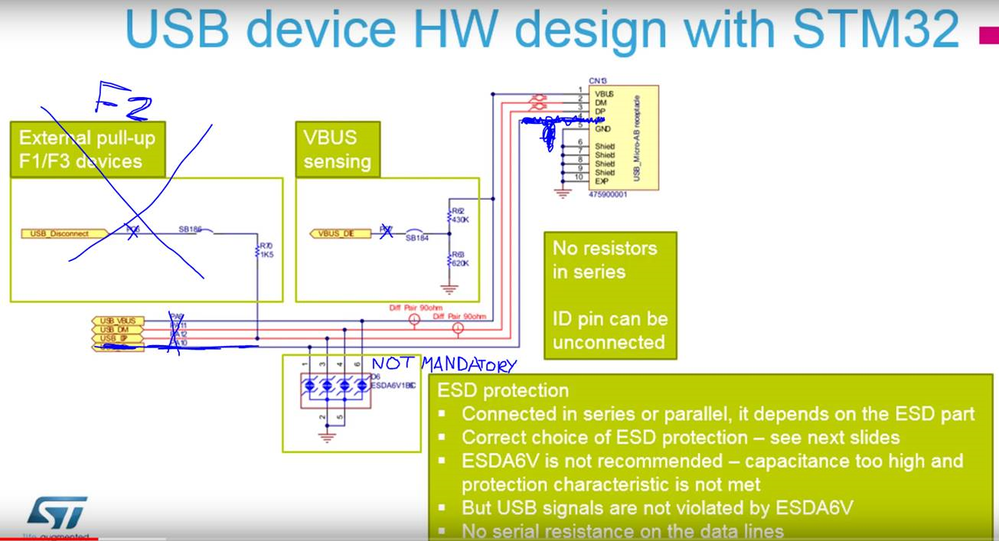

Anyway VUSB needs to have a 2 resistors voltage divider becasue the bus is 5v and the adcs range ends in 3v3 as shown here:
https://www.youtube.com/watch?v=vwlXUOY7KY0&list=PLnMKNibPkDnFFRBVD206EfnnHhQZI4Hxa&index=8

Hi @Ons KOOLI what error you found as i said earlier I am new to usb with stm32 so i seethe youtube example with stm32f4 the only difference that is their is that i donot use gpio for vbus i simply put a resistor divider and activate vbus is they is any other error please let me know so that i can work on it thank again waiting for your support
2021-04-26 2:50 AM
I am using cubemx v4.3 for usb code generate and after that following step provide in training video pls describe what error you are getting so that i can work on it

Hi, @Ons KOOLI as per your advise i revised my project with latest stm32cubef1 library v1.8.3 so i am attached my latest .ioc file and the warning is coming since i have not selected any option for vbus activation since my idea is to always keep vbus on i.e i simply put a resistor divider that has 4k7 and 10k resistance so that i can get supply as per mentioned in hal usb host document i simply do not want to use any gpio apart from that all configuration is done as per ST USB HOST MSC training video ,kindly advise me what is wrong i am doing that my device is not getting detected while debug i always notice my appli state as application start. i don't think it any issue if i donot use any gpio for activating vbus if i am giving continuously the supply to vbus.
