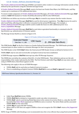

Screenshot from the USB PD 3.1 spec

Hello @DDesr.1 ,
Do you mean the call to USBPD_PE_SendExtendedMessage() returns USBPD_FAIL ?
If so, it is expected as Vendor_Defined_Extended messages are not supported in v5.0.0 of USBPD Core library.
Regards
