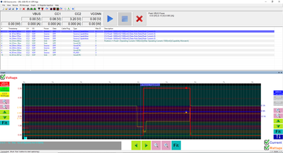

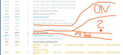

2025-09-08 11:59 PM
Hi @FBL ,
thanks for the support!
As I am running on a custom hardware I wasn't easily able to run STM32CubeMonitor-UCPD, but I managed to at least output the trace as text using the "Select Tracer Port" in the top right (however a txt is generated then instead of a .cpd). Hope this helps as well, otherwise I will need to dig deeper into that. Please find the txt attached.
Here you can see the issue as well: At timestamp 19773 VBus is enabled (which just does nothing in the dummy implementation attached to my first post) and immediately after at timestamp 19773 to 19778 three source capabilities messages are sent out. But in between BSP_USBPD_PWR_VBUSGetVoltage is never queried...
In an external trace tool you can see the same: Without VBus enabling (obviously as in this minimal example I am doing nothing to enable VBus) Source Capabilities are spammed out on CC lines...

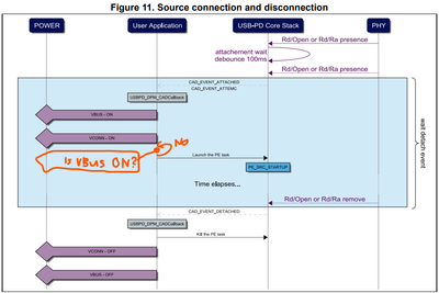

Regarding your first point: I don't really get your point. In my example I am source and not sink. So I guess the relevant timing diagram from UM2552 would be this?
In this diagram there is also nowhere mentioned, that actually for USB PD Compliance you would want to wait between VBUS-ON and probably the launch of the PE Task (or you would need to wait in the launched PE Task) until VBus really is there. So I would expect something like this:
or alternatively the waiting part in the PE Task.
What am I missing?
I can see that the headline of the implementation in my picture is "User Application". Here I have just been using the default generated code by CubeMX:
void USBPD_DPM_CADCallback(uint8_t PortNum, USBPD_CAD_EVENT State, CCxPin_TypeDef Cc)
/* _TRACE */
(void)(Cc);
switch (State)
case USBPD_CAD_EVENT_ATTEMC :
#if defined(_VCONN_SUPPORT)
DPM_Params[PortNum].VconnStatus = USBPD_TRUE;
#endif /* _VCONN_SUPPORT */
USBPD_DPM_UserCableDetection(PortNum, USBPD_CAD_EVENT_ATTEMC);
DPM_StartPETask(PortNum);
break;
case USBPD_CAD_EVENT_ATTACHED :
USBPD_DPM_UserCableDetection(PortNum, USBPD_CAD_EVENT_ATTACHED);
break;
} VBus is enabled in USBPD_DPM_UserCableDetection and immediately after DPM_StartPETask starts the PE Task. Do I have to add a wait manually in here? (actually you don't want to pause the execution in a callback so I guess I would have to do some state machine magic here and remember to start the PE Task once VBus is on...)
Would a handling inside PE Task (or somewhere else where there is already a state machine) not be more elegant?
Looking forward to your response! I feel like I am heading in the wrong direction here...

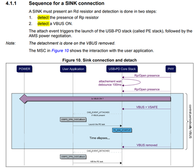

The USB PD stack relies on the CAD state machine to monitor VBUS presence through the power interface functions like BSP_USBPD_PWR_VBUSGetVoltage(). The PE task is triggered by the CAD callback on attach events, but internally the CAD state machine verifies VBUS status before allowing the PE state machine to proceed. This means the stack does not block or wait explicitly before starting PE; instead, it depends on accurate VBUS detection in the CAD layer.
Your observation about missing VBUS voltage queries:

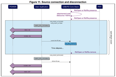

On the figure 11 in UM2552 and compliance:
In my understanding, USB PD specification does not explicitly require a delay between enabling VBUS and starting the PE task. Instead, it expects the CAD layer to handle VBUS detection asynchronously. Blocking inside the CAD callback to wait for VBUS is not recommended and would complicate the state machine.
So what is the recommended approach?
You should implement the power interface functions properly so that BSP_USBPD_PWR_VBUSGetVoltage() returns the actual VBUS voltage. This enables the CAD state machine to detect VBUS presence correctly and only then start the PE task. This approach is cleaner and aligns with the stack’s design.

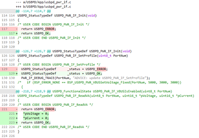

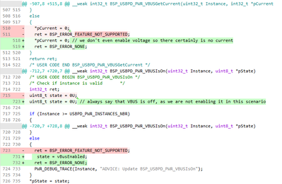

I have also implemented all the PWR functions (which I already had in my base project and just didn't bother to do for the minimal example as it already shows the problem) without any difference, but lets walk through it slowly:
Breakpoints in most of the new ones also never hit. Obviously the implementations are stubs but when VBus does not turn on and VBUSGetVoltage always return 0V then it should never send SRC Capabilities, right? Even if it would magically just not show the call to VBUSGetVoltage in the trace. Or is there a different function that I need to change that is used to determine VBus voltage?
You are saying "Without a proper VBUS voltage measurement, the CAD state machine cannot detect VBUS presence correctly" - I have always had a "propper" voltage measurement. It does always return BSP_ERROR_NONE and put 0V to where pVoltage points, which is correct as I am never really enabling any voltage. Or does the stack implement something like "oh if voltage is exactly 0V all the time, measurement must be faulty, lets just asume VBus is on"?
As you also advise against blocking or adding a state machine I think I should fix this issue, but I don't see the solution yet.

Even with PWR Interfaces implemented nothing has changed (maybe I missed a function, that's why I added the diff images)
So what's next?

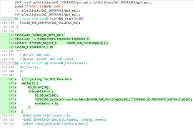

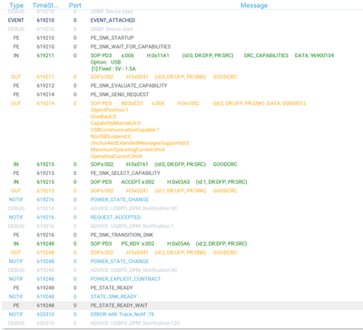

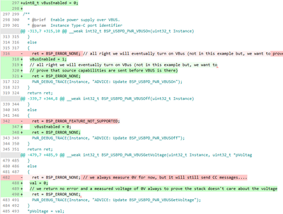

2025-10-01 5:12 AM
Hi @FBL ,

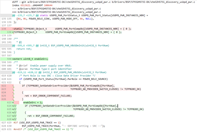

I got a STM32H573I-DK kit, opened the respective USBPD_SRC example in STM32CubeIDE and could reproduce the issue with minimal changes only to delay the enabling of VBus (which resembles the delay a DCDC converter takes to switch to the new voltage setpoint):
Drivers/BSP/STM32H573I-DK/stm32h573i_discovery_usbpd_pwr.c:
Utilities/GUI_INTERFACE/gui_api.c:

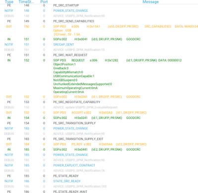

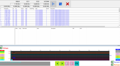

It shows the exact same problem:
The first Source Capabilities Package is sent where the blue vertical line is in the graph (marked with "#0 Source_Capabilities").
This is why USB Compliance Tests of our hardware fail...
Now after recreating it using the Discovery Board, I am clueless on what to do. I guess the problem lies in the compiled binary of the ST USB Library?
@FBL if there is no more hints from your side, could you please connect me with the respecive expert? I certainly need support on this here.

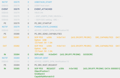

2025-10-10 10:14 AM - edited 2025-10-15 9:15 AM
Hi @abtq
Here is my log using the H573-DK board and the example firmware SRC
About, the first Source Capabilities sent where the blue vertical line is in the graph (marked with "#0 Source_Capabilities") , according to section 6.6.3.3 tFirstSourceCap from USB PD Specification, rev3.2, Version 1.1, 2024-10, the problem here is that it should be within tFirstSourceCap, could you share your schematics?
In discovery kit, I've manually inserted a delay of 100ms between
int32_t BSP_USBPD_PWR_VBUSOn(uint32_t PortNum)
int32_t ret = BSP_ERROR_NONE;
/* Check if instance is valid */
if (PortNum >= USBPD_PWR_INSTANCES_NBR)
ret = BSP_ERROR_WRONG_PARAM;
else
#if (USE_BSP_USBPD_PWR_TRACE == 1)
BSP_USBPD_PWR_TRACE(PortNum, "-- BSP_USBPD_PWR_VBUSOn --");
#endif /* (USE_BSP_USBPD_PWR_TRACE == 1) */
/* Port Role is now SRC : Close Gate Driver Provider */
if (USBPD_PWR_Port_Status[PortNum].PwrRole == POWER_ROLE_SOURCE)
HAL_Delay(100);
if (TCPP0203_SetGateDriverProvider(&USBPD_PWR_PortCompObj[PortNum],
TCPP0203_GD_PROVIDER_SWITCH_CLOSED) != TCPP0203_OK)
ret = BSP_ERROR_COMPONENT_FAILURE;
BSP_USBPD_PWR_TRACE(PortNum, "-- GDP/GDC setting : SRC --");
Here is the trace, we can see that the source capabilities is delayed of 101ms of VBUS ON;
36 CAD 12904 0 USBPD_CAD_STATE_ATTEMC
37 NOTIF 12904 0 USBSTACK_START
38 DEBUG 12904 0 ADVICE: USBPD_DPM_Notification:104
39 EVENT 12904 0 EVENT_ATTEMC
40 DEBUG 12904 0 VBUS ON
41 DEBUG 12904 0 -- BSP_USBPD_PWR_VBUSOn --
42 DEBUG 13005 0 -- GDP/GDC setting : SRC --
43 PE 13005 0 PE_SRC_STARTUP
44 NOTIF 13005 0 POWER_STATE_CHANGE
45 DEBUG 13005 0 ADVICE: USBPD_DPM_Notification:90
46 PE 13005 0 PE_SRC_SEND_CAPABILITIES
47 OUT 13007 0 SOP PD3 s:006 H:0x11A1 (id:0, DR:DFP, PR:SRC) SRC_CAPABILITIES DATA: 96900102 Option: DRD [1] Fixed : 5V - 1.5A /
Without this delay, source capa are sent in 1ms after Vbus on as you can see in the trace
20 EVENT 21310 0 EVENT_ATTEMC
21 DEBUG 21310 0 VBUS ON
22 DEBUG 21310 0 -- BSP_USBPD_PWR_VBUSOn --
23 DEBUG 21311 0 -- GDP/GDC setting : SRC --
24 PE 21311 0 PE_SRC_STARTUP
25 NOTIF 21311 0 POWER_STATE_CHANGE
26 DEBUG 21311 0 ADVICE: USBPD_DPM_Notification:90
27 PE 21311 0 PE_SRC_SEND_CAPABILITIES
28 OUT 21312 0 SOP PD3 s:006 H:0x11A1 (id:0, DR:DFP, PR:SRC) SRC_CAPABILITIES DATA: 96900102 Option: DRD [1] Fixed : 5V - 1.5A /
Reminder, GUI is only for debug. If you don't use UCPD Monitor, you should not be using it.
