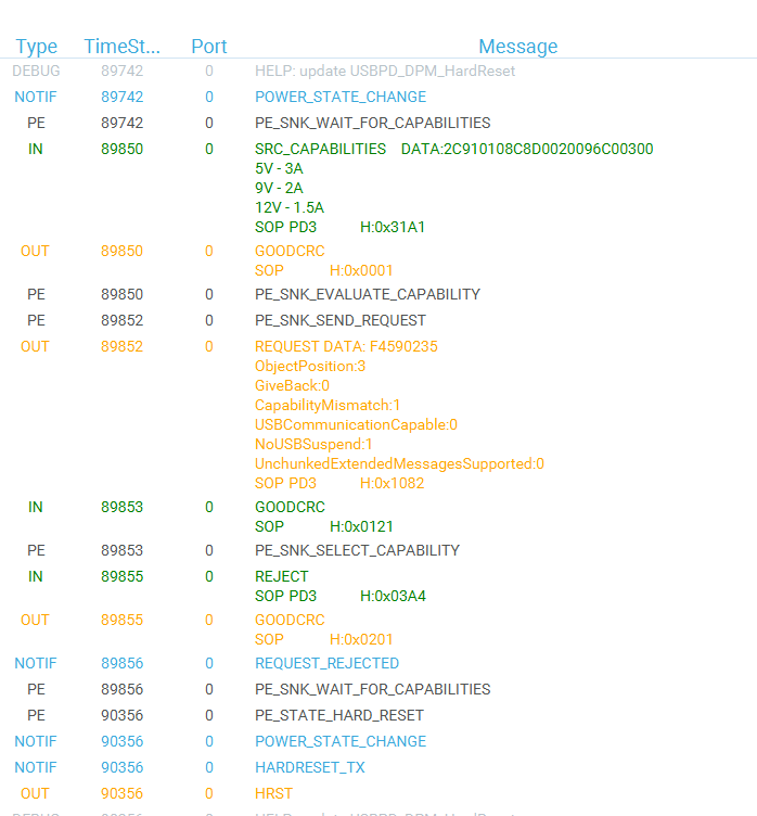

USBPD_NbPDO[0]=7;This works fine (successfully establishes a contract with the highest power available from the source) if we plug our device into a 100W or 60W USB PD charger, but it doesn't work if we plug into a USB PD charger that is only 18W (12V @ 1.5A).
Below is the request that gets made to the 18W charger, but the request gets rejected.
Thank you in advance for any help you can provide.

Hello Tim,
It seems your request is not correct. You request too much current ? (the bit "Capability mismatch" is set)
Can you have a look at our wiki ? There is a specific section about this kind of error.
Then, instead of sharing the picture of the trace, can you share the .cpd file ? (The trace files are saved in c:\Users\%username%\AppData\Local\Temp\STM32CubeMonitor-UCPD\Acquisition\ with ".cpd" extension.)
See also this wiki section related to PDO building policy.

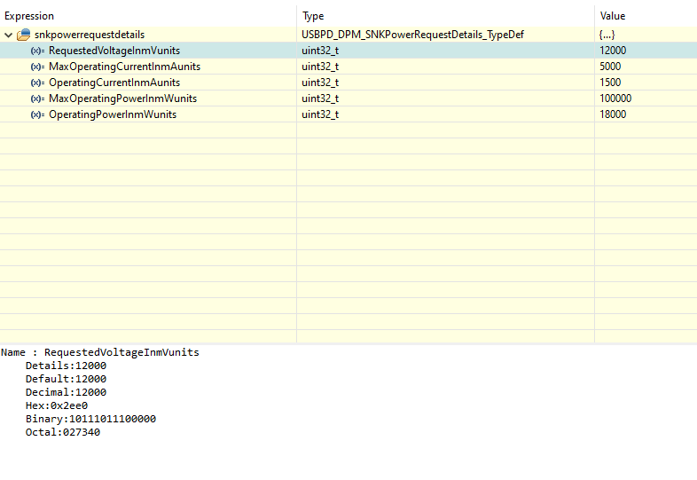

2020-10-06 10:24 AM
2020-10-06 1:00 PM
I believe the capabilities mismatch may be caused by this section of code in usbpd_dpm_conf.h

#endif /* USBPDCORE_SNK_CAPA_EXT */" .OperatingPowerInmWunits = (USBPD_CORE_PDO_SNK_FIXED_MAX_CURRENT * USBPD_BOARD_REQUESTED_VOLTAGE_MV)/1000" is assuming the board draws constant power. But our device can draw dynamic power based on what is available from the source. Should we just set this to a low value (18W for example)?

USBPD_CORE_PDO_SNK_FIXED_MAX_CURRENT has been fixed to 5A and it seems that your power supply does not accept our request with a max current to 5A:
---> 0000008915 P0 SOP s:006 PD3 H:0x1082 REQUEST DATA:f4b10414
PDO position :(1)
NoUSBSuspend : 0
USB Capable : 0
GiveBack : 0
Capa Mismatch : 1
Operating current : 3000 mA
Maxi Operating current: 5000 mA
UnchunkMode Support : 0
<--- 0000008918 P0 SOP s:002 PD3 H:0x03a4 REJECT
Can you just try to sent this defined to 3A?
(usbpd_pdo_def.h)
#define USBPD_CORE_PDO_SNK_FIXED_MAX_CURRENT 3000Yohann
2020-10-07 9:12 AM
Hi Yohann, I made the change you suggested and the request was accepted. This seems to fix the problem. Thank you for your help.
