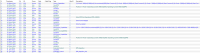

Just to be clear: In my main application (not the minimal sample) it does actually send the USBPD_EXTENDED_CONTROL_EPR_GETSRCCAPA message, the source responds accordingly:
but the ST Stack does not evaluate and respond with a request message.
Also sending the non-EPR equivalent USBPD_DPM_RequestGetSourceCapability(0) in EPR mode does not work. This message is sent and the source responds accordingly but also no evaluation and no request from our side.
