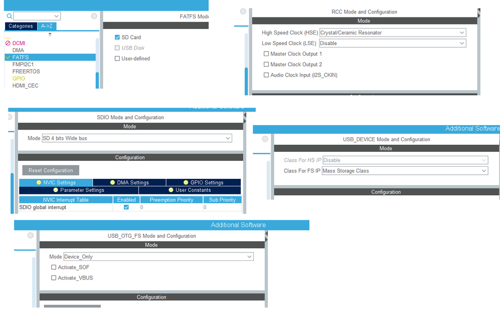

I am trying to configure with the SDIO and the USB mass storage. is it possible to have both option at the same time?
below is the configuration I did in CubeMx.
When compiling the generated source code, getting the below error. can you please guide something what could went wrong?

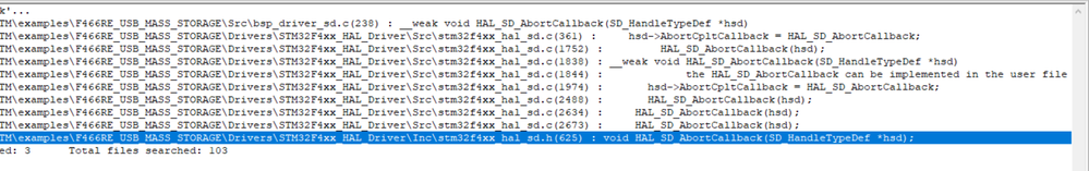

I searched the function it;s in two places.
how to fix it?

changing the IDE from Kiel to STMCube IDE worked :grinning_face:
