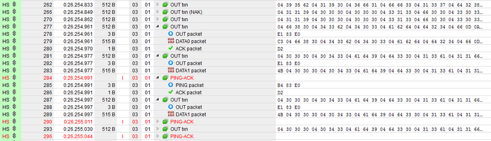

I'm working on a STM32F429-based USB HighSpeed peripheral which exchanges MIDI data with a host computer.If you're not familiar with MIDI, don't worry about it - just know that in the land of USB it's represented as 2 x bulk endpoints. In a nutshell - the problem I'm seeing is that sometimes the STM32 fails to provide a handshake packet (NAK, ACK, or otherwise) in response to a OUT packet to the incoming bulk endpoint of the device. I'm reaching out to see if anyone has experienced a similar issue, hopefully with a workaround/solution. My configuration is as follows:I'm looking at the trace from a USB protocol analyzer and can see the following series of events:
It's worth noting that this problem does not occur if I use either the USB-FS core of the USB-HS core with on-chip FS PHY. But this is at a significantly data rate.

The USB trace is seen below.
2016-03-09 1:01 PM
Follow-Up interesting testing result - simplifying the # of USB devices running on my machine allows the USB transactions to run smoothly without the issue I indicated earlier. I'm going to add the other devices on one at a time to see where things break-down.
