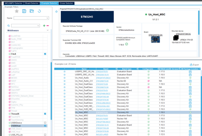

I started taking inspiration from the "Ux_Host_MSC" example project but deleting the USBPD software pack:

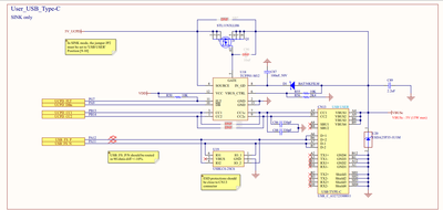

Yes, delete the USBPD software because the nucleo boards have USB Type C Sink only.
However, it is necessary to provide external power to the device connected to the board because, in Host mode, the device requires power.

No in your case, for a USB Host application, the board (HOST) will provide power to the device, when JP2 (USB_USER) is connected. JP2 allows the board to receive power from the host connected via the user USB port.

For the Nucleo board in sink mode (power receiving), the jumper JP2 must be set to "USB USER" so that the board can receive 5V power from the USB port. In this mode, the board does not provide power to the USB device.
If you use the board in Host mode (power supplying), you need to provide external power to the connected device because the board cannot supply power directly through the USB Type-C port.
2025-12-11 5:03 AM
Thank you @T_Hamdi
"the board cannot supply power directly through the USB Type-C port", this is excactly what I was trying to do. I will connect an external board to the CN12 connector using the pins PA11 and PA12 to test my application.
