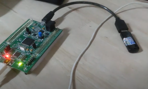

Board name : stm32f746g discovery
I need to update firmware through usb host, i did not get any documents for "stm32f7 series usb host firmware upgrade"
does any one help me ?
For example i need this type firmware upgradation:(it takes from internet)
