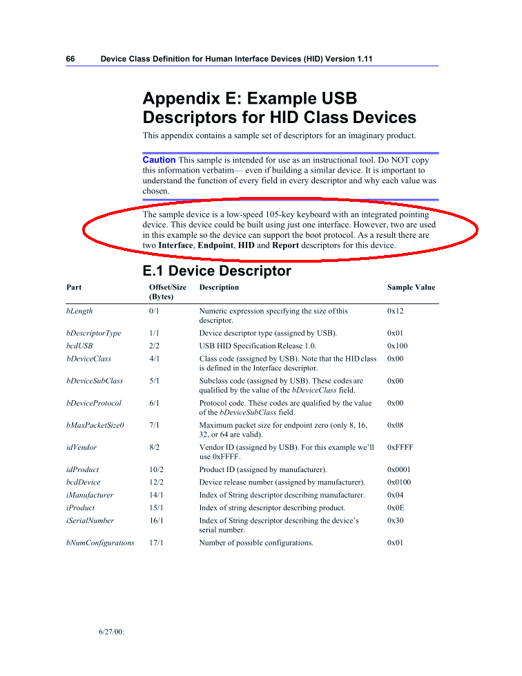

You simply can have several interfaces within one device. See for example appendix E of the HID standard, it gives a keyboard/mouse combo's descriptors.
2020-07-31 3:49 AM
Can you give me a link to the version you reference please. The version I've found https://www.usb.org/sites/default/files/hid1_11.pdf doesn't mention a combo descriptor
2020-07-31 4:22 AM
As that text says, this combination can be pulled out entirely within one interface, too; but then the driver would need to be written properly to handle HID completely, not just boot protocol - and that's far from being trivial.
Presuming you've just slapped on what came with Cube/CubeMX, there's quite some chance standard keyboards wouldn't work either.
What do you mean by "combo descriptor"?
