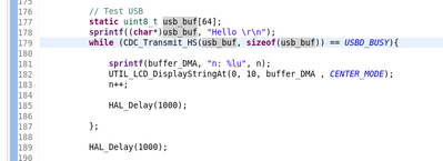

This is my code at the main, I just developed a code to send "hello" every second, and if it is Busy, it will print an increment value on the LCD

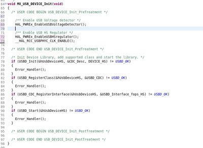

This is my USB init function:
Do you know what the solution can be to the CDC transmission issue with USB high-speed data transfer?

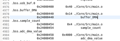

Where is usb_buf located? Somewhere the USB DMA can access?
2025-08-14 2:45 AM
The usb_buf is located at 0x24000400
Can USB access it, right?
