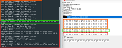

I would like to consult the USB HID GetReport feature.
The issue is that the printout data from MCU log is different from bus hound displayed result.
Bus hound is trial version, the data length indeed is 16.

2025-06-16 6:46 PM
Hi @FBL ,
Thank you for your suggestion.
However, after modification the result still failed.
As the image show above, I found that even I didn't set g_last_input_report for GetReport, there still have data be reported whenever host try to get report from ID 1, and the value seems could be changed randomly.
Besides that, I found that after I set the g_last_input_report which expected to be 01 D4........, though the reported data is not expected, but the value seems keep the same each time.
Not sure whether it is any hint for you to help with the analysis.

}I have modified and add more log info inside the GetReport.
However, the data stil show different from bushound.

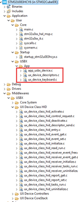

2025-07-02 2:33 AM
Hi @FBL ,
I am using STM32U083 for develpment and the library seems a little bit different from the one you shared.
My file structure is shown as below, I am not sure whether I am using legacy or custom keyborad.
