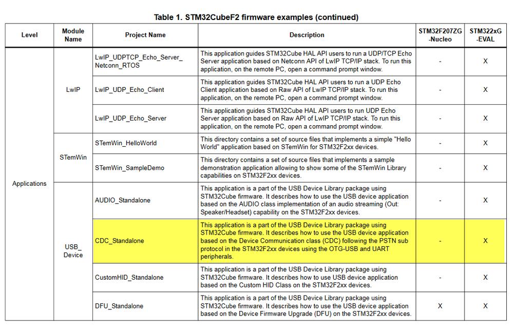

1) Download and review the STM32CubeF2 firmware examples. Table 1, pg 26 states that a full USB CDC example project is supplied for the STM32F2 EVAL board. The EVAL boards are usually more expensive as they are more feature rich. However, you should be able to compare the schematics for the STM32F2 Eval board (207 based) and then apply to your design (205). Consider to even bring in the lower cost STM32F207 based Nucleo board which should also be able to support the CDC example with some minor changes.
2) Do note that the STM32F207 Nucleo is not checked for this full project (CDC device) example so some code changes will be required but we have done similar changes with other processors and the changes were very minor.
