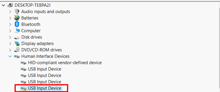

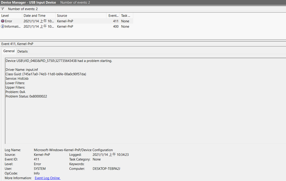

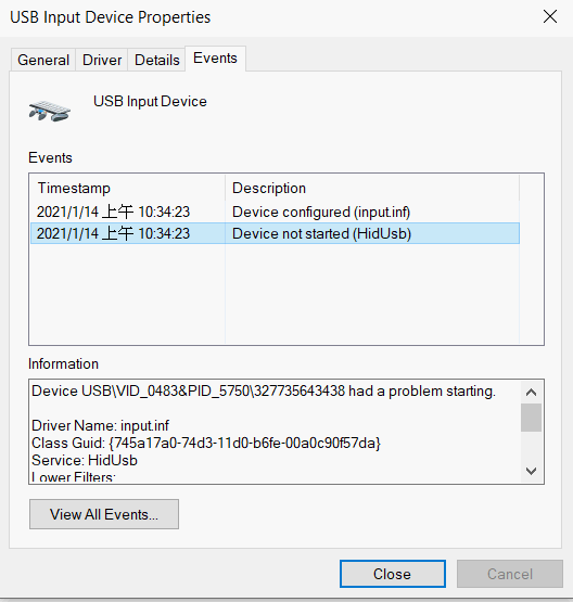

On the Win7, it work perfect, but when I use Win10 as PC Host, it cannot work
just like bellow picture
Please Help me to fix this issue :downcast_face_with_sweat:

Hello @TWu.5 ,
I advise you to follow this article: USB device not recognized with the solution to either increase the heap size, or configure the USB library.

2021-01-26 7:37 AM
Thanks for the reply and help,
I try to close the compiler optimization level , and host can recognize the device
thanks a lot
