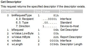

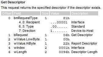

Analyzing USB setup sequence by USBlyzer i found out that wIndex field is responsible for selecting current interface. So my host generates two different requests with wIndex = 0 and wIndex = 1:
I also have modified the code to manage these indexes during class data setup:

Well, I made it work with USB-FS-Device_Lib. My problem was I shouldn't specify interface number 1 for 2nd HID interface in config descriptor. If it help someone in future I leave my config descriptor and Data_Setup code that works for HID+HID composite with different endpoints. Thanks everyone for your help!

}The issue was I had number "1" in line 69.
