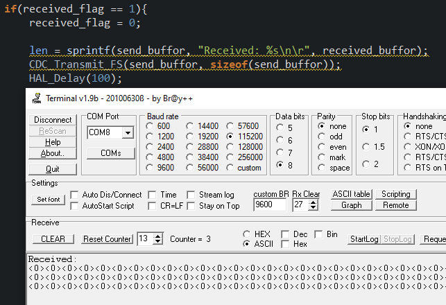

2021-11-16 4:05 AM
Hi, thanks for your answer! Whats sad about it, is that it doesn't work for me :\ Tried different delays (from 10, to 1000 ms). On terminal it looks like maybe its working, but i can't see received data.

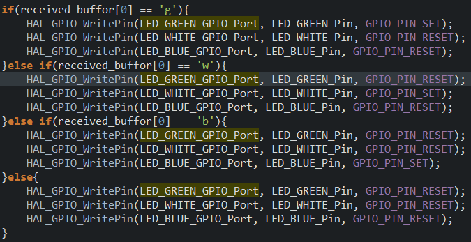

2021-11-16 4:07 AM
Also, received_buffor doesn't contain the data I've sent, because these conditions don't work (they worked before):
2021-11-16 4:36 AM
This could be a pointer's problem. (youre mixing and twisting * with & with nothing at all)
Are you using the debugger?
what happens if you do this
len = sprintf(&send_buffor, "Received: %s\n\r", received_buffor);
2021-11-16 5:02 AM
Where I'm mixing it? Right now I have the same code as yours.
When I do "this" nothing changes, it's the same.
2021-11-16 5:33 AM
