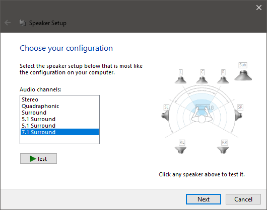

Hello! I'm making an USB sound card and I need that it would have several audio channels configurations like at picture below.
My thoughts about USB device topology:
IT (1) - --------------- | --- SelectorUnit - FeatureUint - OT
IT (2) - MixerUnit - |
As a test I made USB descriptor for IT1 with 4 channels and IT2 with 2 channels. In device manager new device appears under sound devices with exclamation mark. But USB descriptor dump unility does not detect any errors in descriptor.
Do I understand correct that to have multiple audio channels configurations one needs to realize USB device topology with several Input Terminals and Selector Unit?
Please, could someone point out mistake in descriptor (attached)?

Thanks for reply, waclawek.jan . I have read documents you refferenced before trying to make descriptor (and several times while making), but have not found out it is possible to use multiple IT of audio streaming type and multiple corresponding OT of type speaker or it is not possible and how to have multiple audio channel configurations. If I change type of one IT to other than audio streaming, for example to Microphone and make necessary modifications to OT and endpoint, the device is recognized by OS as expected: one speaker and one microphone, and device works fine. If one IT type is SPDIF, then also everything is alright. OS does not recognize the device correctly only if both ITs are of type audio streaming and OTs are speakers. I didn't manage to find any information about such a case: is it actually real to have multiple OTs of speaker type to provide for user possibility of selecting audio channel configuration?
I tired using descriptor from existing soundcard but everything I got was blue screen and system crash sourced from USB.sys.
