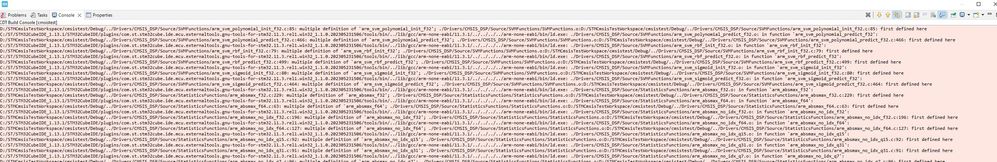

I am trying to use the newest cmsis dsp library (v1.15) to implement a vector matrix implementation. I am running into a "first defined here error" when trying to build with the cmsis dsp library (v1.15). I created an empty project just to try out building a project with the library included. I am running into the same issue there.

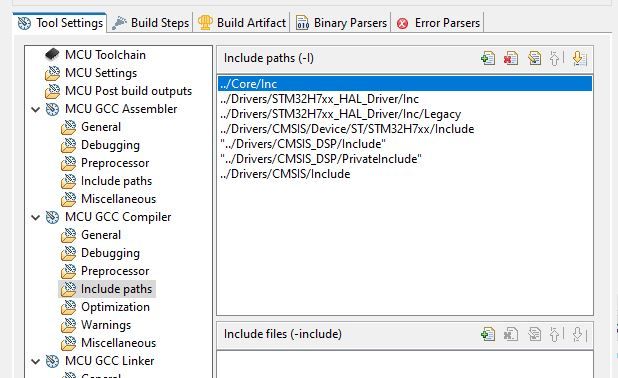

If I understand correctly, CMSIS v 1.15 does not have a "lib" folder anymore like the older versions and only the Include, PrivateInclude and Source folders must be integrated. Therefore the instructions in Configuring DSP libraries on STM32CubeIDE - STMicroelectronics Community are not helpful to me.
Here you can see the folders I included.

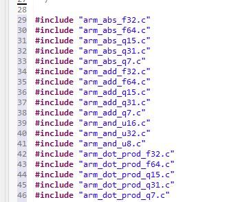

Doing so results in a multiple definition error. The reason for this is, that the subfolders of "Source" have a ".c" file beginning with a capital letter (in the "BasicMathFunctions" folder it is "BasicMathFunctions.c" and BasicMathFunctionsF16.c").
These files include ".c" files causing the multiple definition error on my system.
Excluding these ".c" files from my build fixed my issue. Solved: Re: Error including the CMSIS include files in the... - STMicroelectronics Community describes a similar problem to mine.

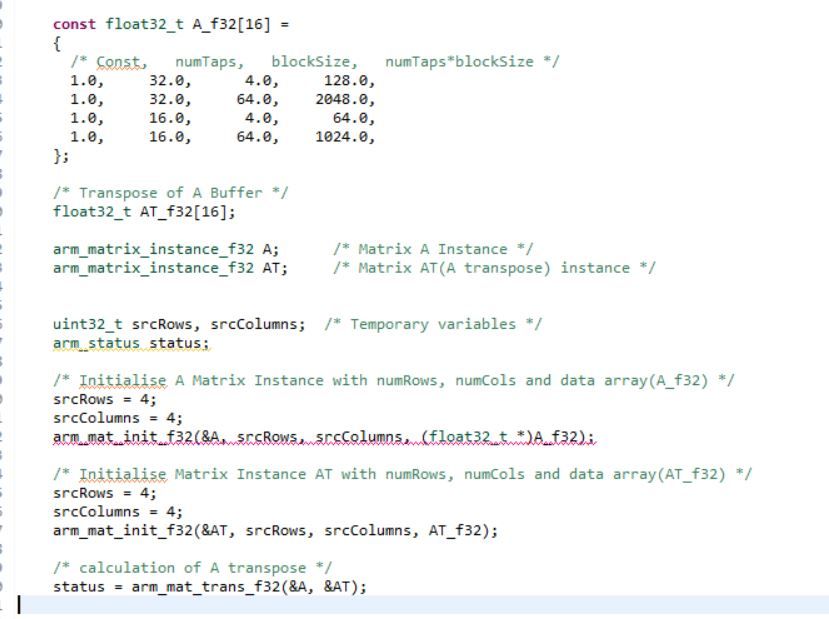

When I remove the "Source" folder, the project compiles without errors. As soon as I am using functions included in the arm_math.h I get an "undefined reference" error. 
Here is the code in my main function. 
A new path ist added to support the header files (as shown in my original post).

Building the project works and using functions such as "arm_mat_trans_f32" work when using the headerfiles of the newest CMSIS version.
I tried to implement the vector matrix multiplication, that I intended to use the updated library for, as these functions are not included in older versions of CMSIS. When compiling I get a "undefined reference to 'arm_mat_vec_mult_f32' " error.

I'd add that this applies to all source folders. If you're using MatrixFunctions for example. Comment out the contents of MatrixFunctions.c and MatrixFunctionsF16.c
