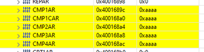

}But that just gave me:
So, the first value is copied into all the configure registers.

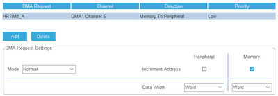

OK, so maybe I have to set the "Increment Address" for the DMA configuration:
But this results in only one register being updated:
I am puzzled!
