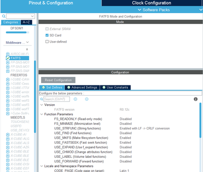

How to start with a new configuration via STM332CubeIDE (without the BSP and files linked with the evaluation card)
I have a version that works but not all the time and I don't know where this could come from.
2025-01-07 6:54 AM
@Andrew Neil wrote:I would start by cutting-down your EV code to just your minimum required for the SD Card.
This point is very difficult for me without the '.ioc' file because there are too many references in standard definitions, function calls, etc. This quickly becomes incomprehensible

As you are using CubeMx I invite you to watch that video especially at 5:59 on how to configure SDcard pin detection on CubeMx.
Hope that gives you more visibility on the subject.

Did you see the start of my topic ? For 1 line of code there are 4 or 5 references and it becomes unreadable. Of course, putting the code on the SD card is easy when you know it, but when you start, for me it is better to start with CubeMX and eventually complete it later.

CubeMx helps you to speed up the development but needs from you to understand what you are doing.
Did you watch the video of the card detection config with CubeMx that I shared in a previous comment?
