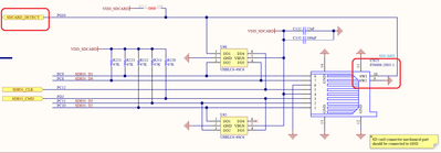

2025-01-07 5:39 AM - edited 2025-01-07 5:41 AM
Hello @DYann.1 ,
Basically (on the eval board) the card detection is based on a GPIO. And the detection is done based on a switch on the SDcard embedded in the slot:
From the Eval SDcard BSP:
int32_t BSP_SD_DetectITConfig(uint32_t Instance)
this API is responsible of the config of the GPIO.
And these line needs from stm32l552e_eval_sd.h are responsible to set the correct GPIO to be used/ the correct NVIC line and the IRQ handler using PG10 pin as indicated by the schematics above:
#define SD_DETECT_PIN GPIO_PIN_10
#define SD_DETECT_GPIO_PORT GPIOG
#define __SD_DETECT_GPIO_CLK_ENABLE() __HAL_RCC_GPIOG_CLK_ENABLE()
#define SD_DETECT_IRQn EXTI10_IRQn
#define SD_DETECT_IRQHandler EXTI10_IRQHandler
#define SD_DETECT_EXTI_LINE EXTI_LINE_10
If you need to use it in interrupt mode you need to use this callback:
BSP_SD_DetectCallback(uint32_t Instance, uint32_t Status)
In case of polling you need to use:
int32_t BSP_SD_IsDetected(uint32_t Instance
Hope that answers your question.
