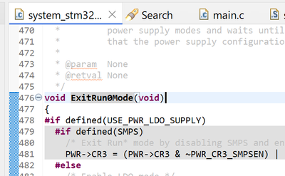

2025-11-27 7:12 AM
Here is a definition of that file. Maybe it's the one you want.
Would be better for you to provide your IOC or explain how you project was created. If the function is there, it should be found.

2025-11-27 7:48 AM - edited 2025-11-27 8:01 AM
If I open your IOC and generate code and compile the project, it (mostly) works.
Except that you have do not generate main checked, so it doesn't generate that.
If I add main(), it compiles.
Finished building target: SpectrumAna.elf
arm-none-eabi-size SpectrumAna.elf
arm-none-eabi-objdump -h -S SpectrumAna.elf > "SpectrumAna.list"
text data bss dec hex filename
9396 8 2112 11516 2cfc SpectrumAna.elf
Finished building: default.size.stdout
Finished building: SpectrumAna.list
ExitRun0Mode is generated and present in system_stm32*.c
I wonder if you are not regenerating code.
