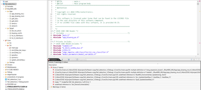

I am working on a project to include edge impulse package into my code. But while integrating edge impulse package I got to change the c file to cpp. But the Ble package which was working fine prior is now not work fine as the code converted to cpp.
the files in bluenrg_ms file is not detected for the definition of functions to source code in main().

@Abin_19 wrote:I got to change the c file to cpp. But the Ble package which was working fine prior is now not work fine as the code converted to cpp.
Could this be due to C++ name mangling?
BTW: it's better to post the messages as text rather than a screenshot - copy & paste from the 'Console' tab ...
also, there's generally more detail in the 'Console' output.
