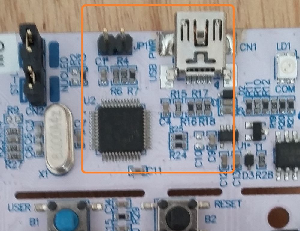

You'd have to add a USB port to the F401RE to be able to talk to it via USB.
The USB on the NUCLEO-64 boards talks to the F103 implementing the ST-LINK/mbed functionality.

The board has a USB connector, it communicates with the STM32F103 chip, and NOT the STM32F401RE, that's what I said/meant.

Here is a setup image which I am using. I am using a custom connector on CN10 to have USB connector.
https://os.mbed.com/users/va009039/notebook/F401RE_USBDevice/#commentform
