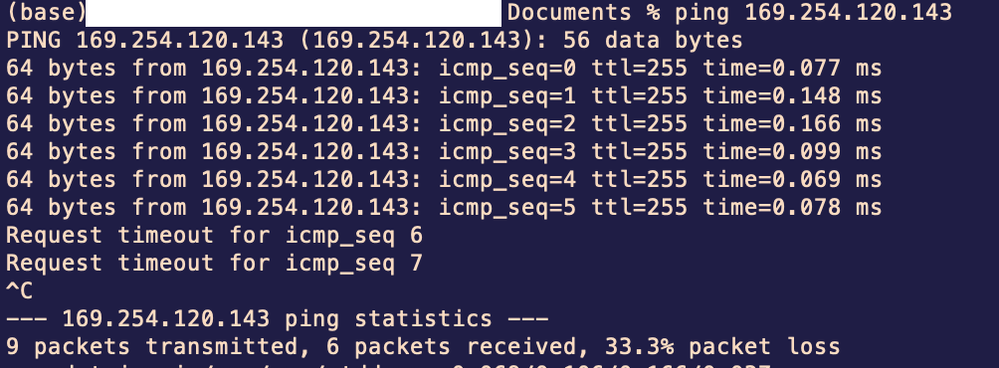

Hi LCE,
I think it is the discovery board as when I ping it while connected, it is able to ping it correctly but as soon as I plug it off it is unable to ping it anymore like in the screenshot attached. But I will try to get my laptop working as a DHCP server first. Any other suggestions? Thanks

Address like 169.254.x.y is APIPA address.
Check if your LwIP options file enables APIPA.
2022-04-06 2:29 PM
169.254.x.y is consequence of AUTOIP being enabled in lwipopts.h
http://www.nongnu.org/lwip/2_0_x/group__lwip__opts__autoip.html
Check if you have DHCP enabled, if dhcp_start() is called for the ETH netif, observe the netif's dhcp struct values, observe on bus if your device sends DHCP_REQUEST broadcasts... i.e. debug as usually.
