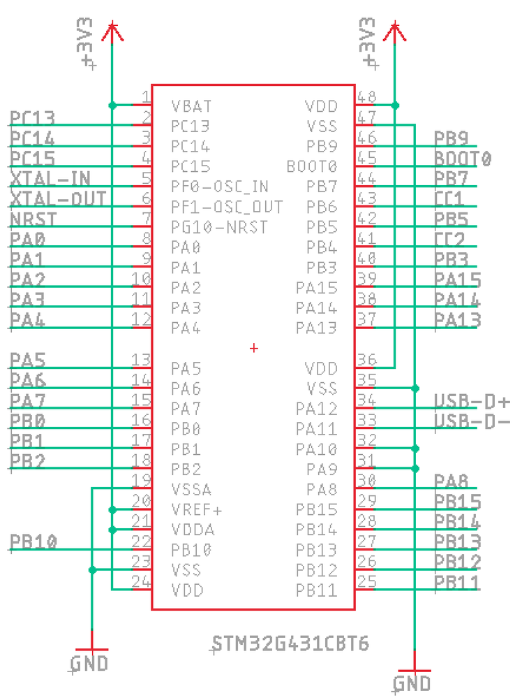

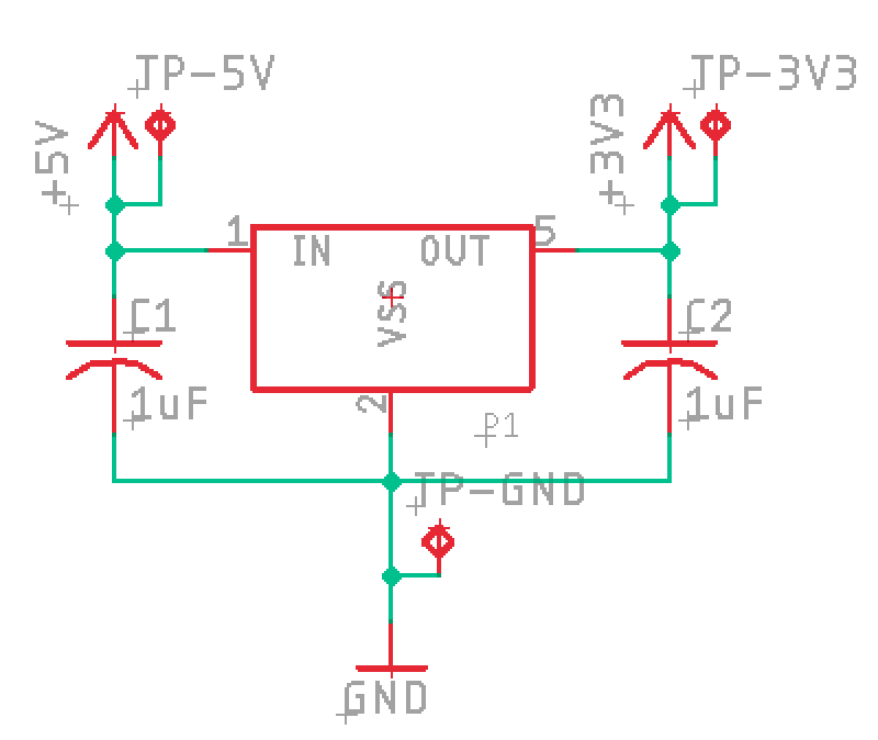

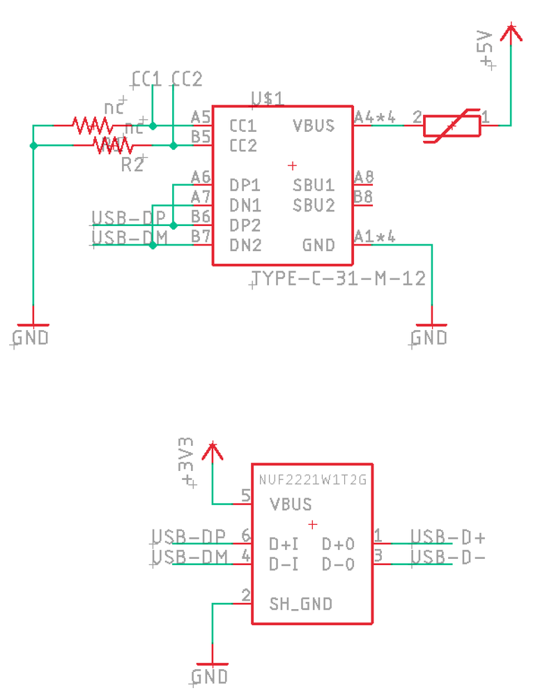

I'm looking into using the STM32G431CBT6 for a usb device which might need more than 500mA (it's a _really_ bright keyboard).
If possible I'd like to avoid adding a battery to power the MCU up. Also flashing via DFU is a must because nobody has a STLink programmer flying around or knows how to use it.
I've build a breakout PCB around my understanding of the documentation with a USB-C port:
Now when I populate the resistors R1 and R2 in above schematic the breakout board is flashable via DFU. Everything works like I want, however I suspect that populating external Rd resistors will prevent the MCU from negotiating more power (say, 1.5A).
So I'm wondering if I can basically achieve flashing via DFU without populating the two external resistors, using only the internal resistors on the MCU.
And if I have to populate the external resistors, can I still negotiate PD up to a high profile?

Just FYI: using a Type-C connector, you can draw up to 3A of current if your source can provide it, even without USB Power Delivery. The USB Type-C spec requires this, and describes it in detail (with references and examples) starting in section 4.6 Power.
