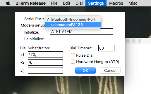

UART_Printf example (Nucle-F767ZI, 144 pins) works correctly, I get printf output on OS X, using Zterm (PC HyperTerminal replacement).
However mouse is locked when I connect with Zterm and start listening. Computer is thus barely usable, I have to revert to keyboard-mouse accessibility feature (mouse mapped to numerical keys). The same happens with Coolterm, so this is not Zterm specific. Below is the USB-serial device that Zterm selects:
Mouse must be in the same ''channel'' with STM32 in usbmodemFA133. Can ST provide support on this? How to add additional ''usbmodemFAxxx'' driver, separate for STM32 board (Nucleo-F767ZI) ? Internet is blank at this. I think many users can have similar issue.

you dont need zterm or anything. from the shell prompt you can simply
$ screen /dev/tty.usbmodemXXXXXX 115200
your problem is a zterm problem or install problem not a serial port driver problem or stm32 problem.
Posted on January 26, 2017 at 23:32
I've did:
screen /dev/tty.usbmodemFA133 9600
and it's the same – mouse is blocked. I kindly ask to include this generic problem in ST support, so that STM32 can print to UART.
