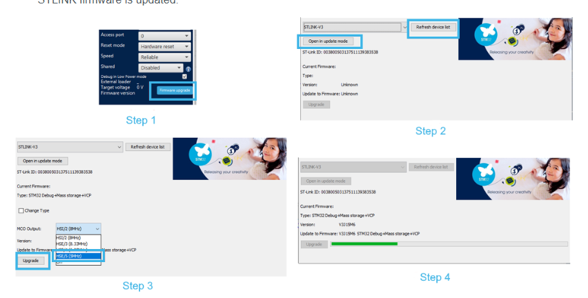

I'm trying but as shown in my previous post, I don't get the same thing as you in STM32 Cube Programmer
2026-03-18 5:46 AM - edited 2026-03-18 5:49 AM
@AmGo wrote:
Also, when I open SM32Cube Programmer and click on ‘Firmware Upgrade’, I get this and nothing else;
Please review the article again. I think you are not following the details.
You need to click "Open update mode" as indicated in the Step 2 shown above.

2026-03-18 5:50 AM - edited 2026-03-18 5:51 AM
@AmGo wrote:
This shows me the bytes transmitted by my UART and with my problem, instead of 0XBE I receive "Framing Error"
Please stick on the STLINK-MCO output problem for now.. Most probably the MCO output is not set to 5MHz as it should.

I've retried the configuration and now I can see MCO Ouput. You were right, I've changed it to HSE/2 to HSE/5.
2026-03-18 5:58 AM
Does it work after this change?
2026-03-18 6:01 AM
Yes, it looks like.
Thank you very much.
