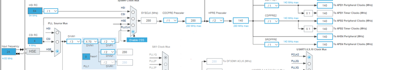

Q2) Here's a snip of the CubeMX clock configuration tab for the timers on the APB1 and APB2 timers. In order to calculate the clock frequency being fed to those timers, I need the values for SYSCLK, CDCPRE Prescaler, HPRE Prescaler, CDPPRE1, CDPPRE2. I can get those directly off registers or by using HAL or LL calls. The problem is the little X1 multiplier ahead of the "To APB1 Timer Clocks" and "To APB2 Timer Clocks" on the right side of the figure below . That multiplier can be X1, X2, X4 or other values depending on the APB1 and APB2 peripheral clock values. It appears that CubeMX sets that multiplier value based on some internal algorithm and I can't find a way to read that value from my program. Is it possible to get that multiplier value programmatically?

@Rob.Riggs There's nothing wrong with the #define, it just seemed a little odd given that I can get all the other stuff from registers. And thanks for pointing me at those 2 functions.
My biggest issue seems to be with the X1 boxes that I mentioned in my OP. The actual value doesn't seem to be anywhere I can get access to it.
