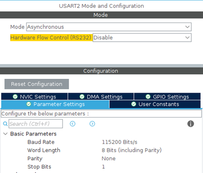

Obviously you set something wrong ..in clock tree, or uart setting.
see:
