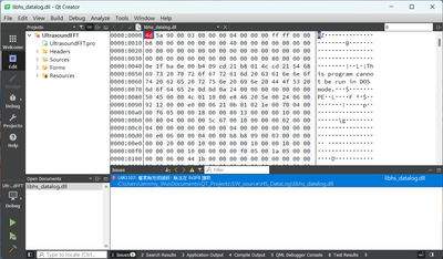

This's my screenshot for your reference. Please ST kindly support this. Thanks in advance.

The DLL included in the UltrasoundFFT project within X-CUBE-MEMSMIC1 is not corrupted as stated in the compiler message, it is simply meant to be compiled with GCC and not MSVC.
When you load the project, if you select MinGW 32-bit as a compiler, you are able to compile everything without any issue.
2023-12-01 1:53 AM
@Davide G Yes, it works. Thank you, Thank you so much for help.
