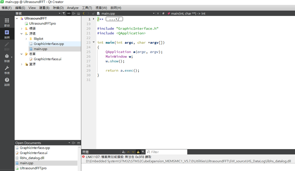

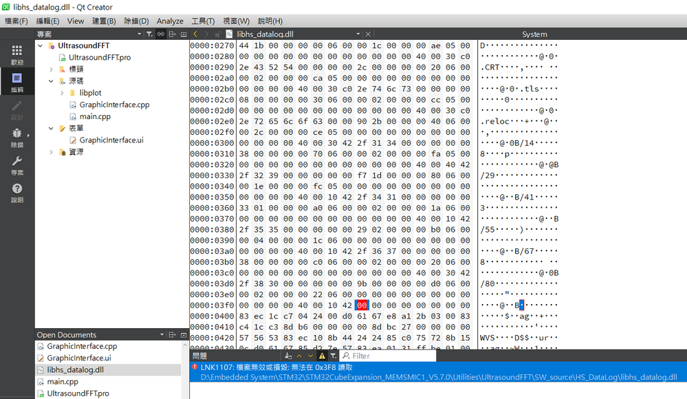

Dear MEde:
I have the same question to compile Ultrasound FFT from SW_Source using QT and getting an error message that libhs_datalog.dll is corrupt.
How to fixed the bug? Could you help provide any solution?
The specific message is LNK1107: invalid or corrupt file cannot read at 0x3F8 shown below.

Dear All:
We have the same question to compile Ultrasound FFT from SW_Source using QT and getting an error message that libhs_datalog.dll is corrupt.
How to fixed the bug? Could any experters help provide any solution?
The specific message is LNK1107: "invalid or corrupt file cannot read at 0x3F8" shown below.

C:\Users\mikeede\Documents\UltrasoundFFT\SW_source\HS_DataLog\libhs_datalog.dll:-1: error: LNK1107: invalid or corrupt file: cannot read at 0x3F8
