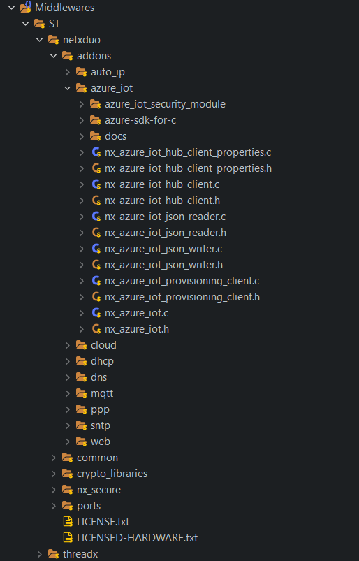

Recently I have been trying to implement an example from ST where data is sent telemetry to Azure. The problem is that Stm32CubeIDE did not generate Netxduo / addons / azure_iot. I am trying to manually add this folder but there are a lot of errors regarding includes and in the example I do not see these folders and files, although in some files they have #include "nx_azure_iot_json_reader.h" which is part of azure-sdk-for-c. If you have any ideas where you need to select somewhere in Stm32CubeIDE to generate this file, please give me advice.
Link to example: https://github.com/azure-rtos/getting-started/tree/master/STMicroelectronics/B-L4S5I-IOT01A
Stm32CubeIDE version: 1.8

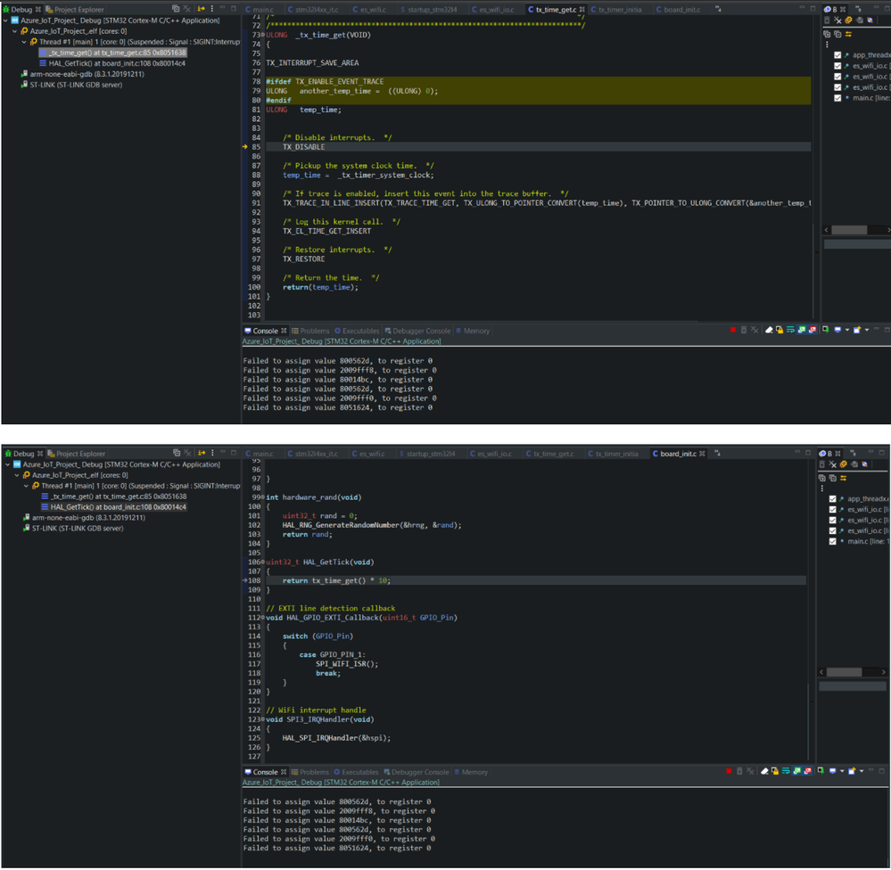

The problem seems to be related with SysTick.
2022-03-30 1:03 AM
@Haithem Rahmani
Also i redefined "HAL_InitTick" based on: https://github.com/azure-rtos/getting-started/blob/master/STMicroelectronics/B-L4S5I-IOT01A/lib/stm32cubel4/Drivers/STM32L4xx_HAL_Driver/Src/stm32l4xx_hal_timebase_tim_template.c
but again i received this:

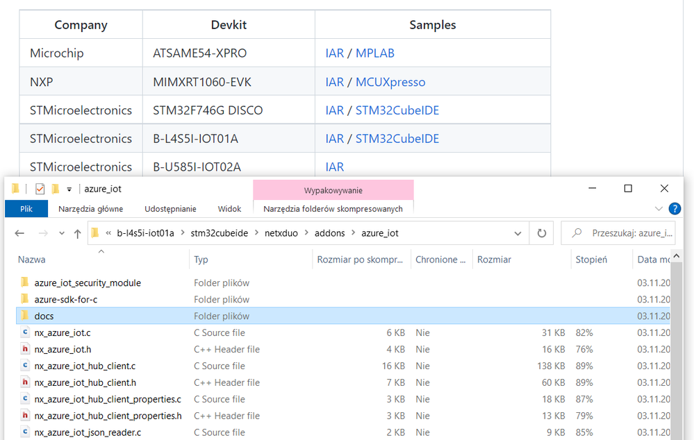

I create a AZURE RTOS project for stm32h723 nucleo board with latest IDE, H7 and AZURE sdk. I couldnt get the "Netxduo/addons/azure_iot" to my custom code from select component section of tool, I guess there is a bug on STM32CUBEIDE.
Is there any workaround for that?
Umit
2022-09-20 2:15 AM
@umtkyck
I had the same issue and I fixed that by adding manually this package. I had a lot of work but I recommend you download one of these package, choose a project to Stm32CubeIDE then find the folder where is azure_iot and finally copy it to your project and add a path to the linker. I believe that this file (azure_iot) is a general file for any microcontroller and you can copy that peacefully and configure on your own. I hope that it will help you
