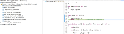

I am not sure about that. At this moment I know that it does not come out tcp init() function. Is the configuration looks good to you? But my other task of touchgfx works even if this task stuck here.

Hello @PushparajAdka
Your configuration is good. However, it is important to know at which point the program get stack.
It may hang in certain ISR when start executing tcp_init.

Juste pause the debugger right after the execution of tcp_init.
2025-08-11 7:42 AM
So I figured out that the code get's stuck here.

It does not come out of this function and when i pause debugging it goes and hangs as I showed in above picture.
