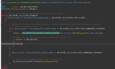

I'm trying to setup TLSv1.3 using STM32H63 Nucleo board. I followed the steps in https://github.com/eclipse-threadx/rtos-docs/blob/main/rtos-docs/netx-duo/netx-duo-secure-tls/chapter3.md to enable TLSv1.3 in STM32CubeMX. But all I get from the OpenSSL server is:
ssl.SSLError: [SSL: NO_SUITABLE_SIGNATURE_ALGORITHM] no suitable signature algorithm (_ssl.c:1006)
How do I solve this? I checked with the debugger and I can see that this code gets hit

CONNECTION CLOSEDWhile debugging I can see this
With status values of 0x20007.
I checked if the server can be connected using openssl client mode
openssl s_client -connect 192.168.1.15:6000 -cert certsv2/client.crt -key certsv2/client_key.key -CAfile certsv2/rootca.crt -tls1_3 -sigalgs "ECDSA+SHA256"and it seems to work with that.
Is there some other NetXDuo thing I'm missing?
2024-09-19 5:00 AM
Status value 0x20007 could be NX_CRYPTO_PTR_ERROR defined in nx_crypto_const.h.
It looks like an incorrect netxduo configuration in the code running on the STM32.
How is the memory allocated ? is there enough memory for a TLS network stack ?
It's difficult to understand the root cause without the full project sources you are using.
Did you modify an example provided in Cube H5 package ? (Nx_IPerf, NX_UDP_echo_client, ...)
The full ServerHello packet details from wireshark , and the full openssl s_server trace (with -trace option) could help.
