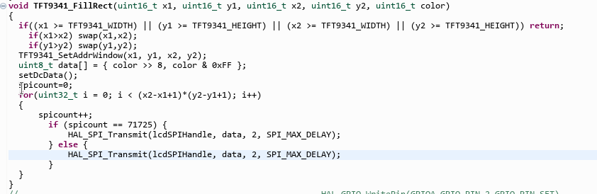

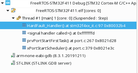

I tried to print a rectangle on my display, that worked a million times before. The first image shows the loop that is used to draw it on the screen. I added the if and the spicount variable to be able to jump directly to when it happens during debuging. I use the ST-Link v2 for debuging.

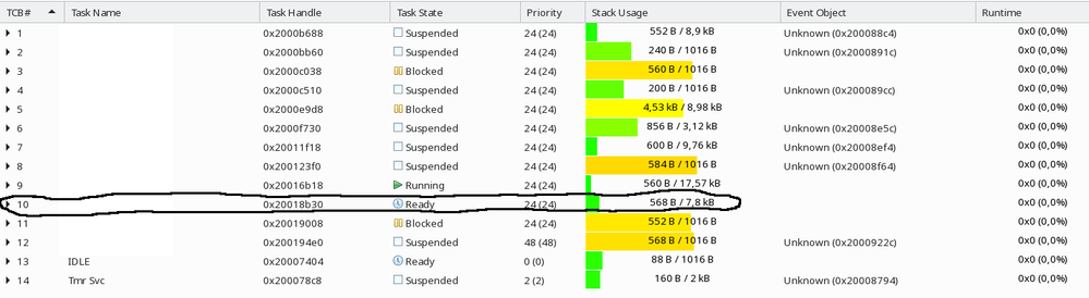

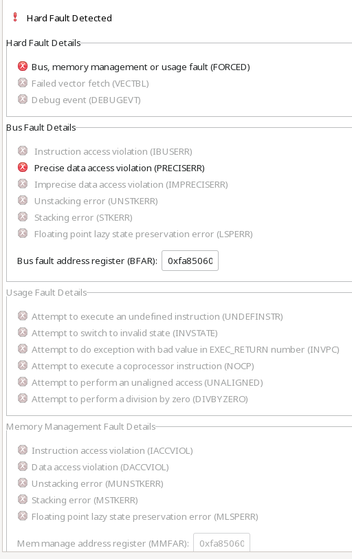

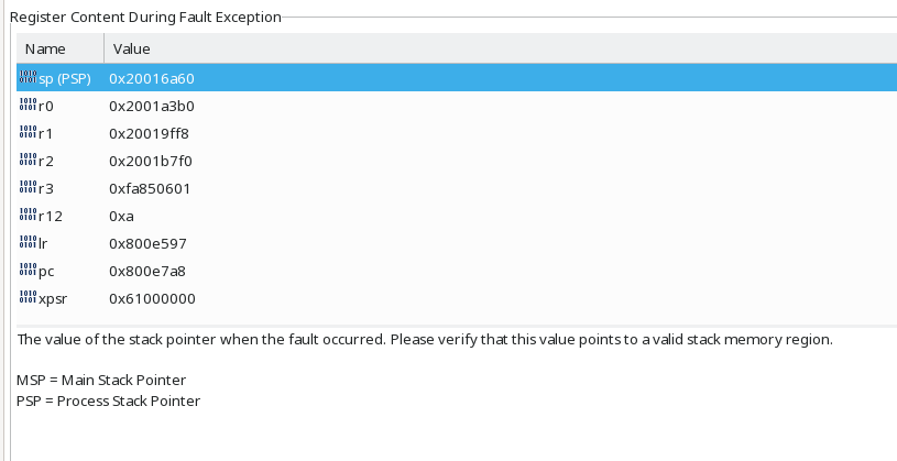

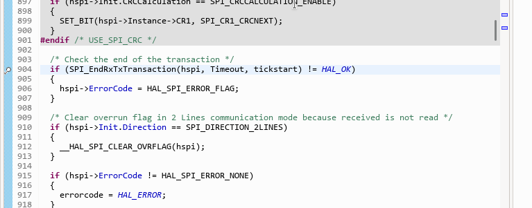

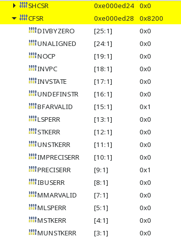

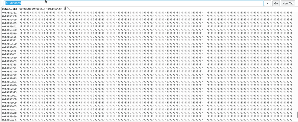

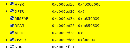

When I try to step into the HAL_SPI_Transmit function for the 71725th time, the hard fault error occurs deep down in HAL_SPI_Transmitat line 904 (image 2). When I try to step into that function (F5), it immediately turns to HardFault error handler. However, when turning on the "Intruction Stepping Mode", the program continues, as if there where no problem, I can switch back then to line stepping mode and the problem will occur later (but always before stepping into a function). I looked at the CSFR register (image 3), it says precise error, but BFAR (image 4) content seems to be strange to me (the memory adress points to memory mapped peripherals and it comepletely empty [image 5&6]). Also, I added the FreeRTOS task view, the Fault Analyzer output and the stack trace (which is inaccurate btw., this is not the function that caused the crash). I am really starting to run out of ideas how to continue. Thanks for reading:)

Points to an illegal address, so the handle or instance data is getting corrupted.
Start sanity checking those values, and identify when they first get corrupted, and before you hard fault on them.

Hi, thanks for the answer. Do you mean the lcdSPIHandle / the uint8_t data[] array in TFT9341_FillRect? I checked that during debuging, the values are stil the same as in the 71724 walks through the loop before. Would that explain the "not stepping into function" behaviour? What could be the reason for corruption? I already tried to find possible buffer overflows and invalid free calls.
Why do you think so?
It appears to be part of the RTOS (task switcher?), it may quite well crash, e.g. due to stack corruption (read: try increasing task stack or whatever they call it in RTOS, I don't use RTOS).
