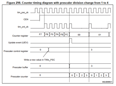

2025-08-31 12:05 AM
The timer pre-scaler register is buffered. The pre-scaler value set in line 3 is only effective after an update event.
Line 4 generates that update event.

> does it mean that i get the interrupt timer over flow interrupt immediately
Generating an update event will cause an interrupt if the update interrupt is enabled.

2025-08-31 7:47 PM
Line 4 is written to do the thing it says it does in the comments.
/* Force the TIMx prescaler with immediate access (gen update event)
In other words: to update the prescaler. event is generated because prescaler is preloaded.

2025-08-31 8:52 PM
Thank you for the clarification, at present i am trying to understand the code of how input capture works and the speed measurement of the motor, as per the user manual the pre-scaler will be adjusted based on the speed of the motor.
After your explanation i can understand that the pre-scaler register value will be loaded into the pre-scaler buffer after the update event and it is not required to generate interrupt. I was of the impression that event always causes an interrupt.
2025-08-31 11:24 PM
As @TDK said above, if the interrupt is enabled, it will; if it's not enabled, it won't.
It will set TIMx_SR.UIF, though, so you want to clear this bit before interrupts are enabled.
Read the TIM chapter in RM.
