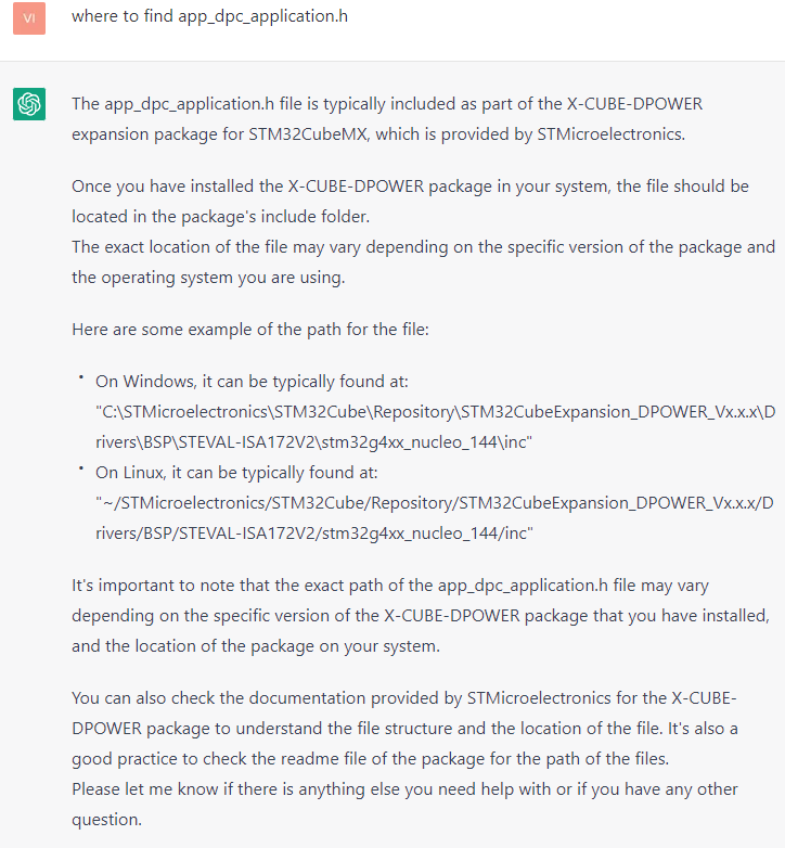

I asked chatgpt regarding  "app_dpc_application.h", here is the response.
