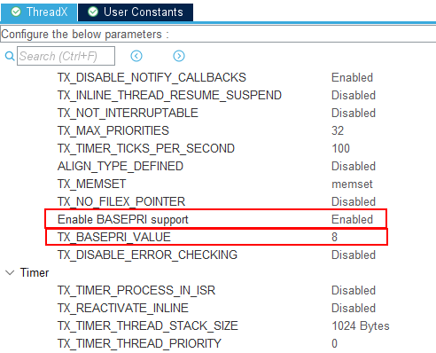

Could you please instruct how to implement your answer" ThreadX is disabling all interrupts including the TIM6 one. in the ThreadX 6.1.8, there was support for the BASEPRI, allowing the application to define the subset of interrupts to mask. This should fix your issue."
Is this done by modifying existing library code, via CubeMX settings, What?

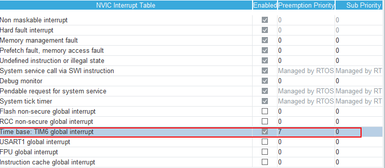

Indeed you can configure this via STM32CubeMX as below.
2. go to the NVIC config panel and set the TIM interrupt priority to any value greater than "8"
doing that the threadx will not mask the TIM 6 any more, but this may impact the overall behaviour of you application as each 1ms a TIMER interrupt will be received and needs to be managed.

I had the same issue with the STM32U5A5 Eval board, where HAL-Delay() seems to run strangely when ThreadX goes to standby with peripheral interrupts disabled (is this a correct assumption?). I fixed this by pushing TIM6 to priority level 14 from 15 and enabling BASEPRI Support with level 15. I wonder if there are certain guidelines or good practices to determine the correct setting.
