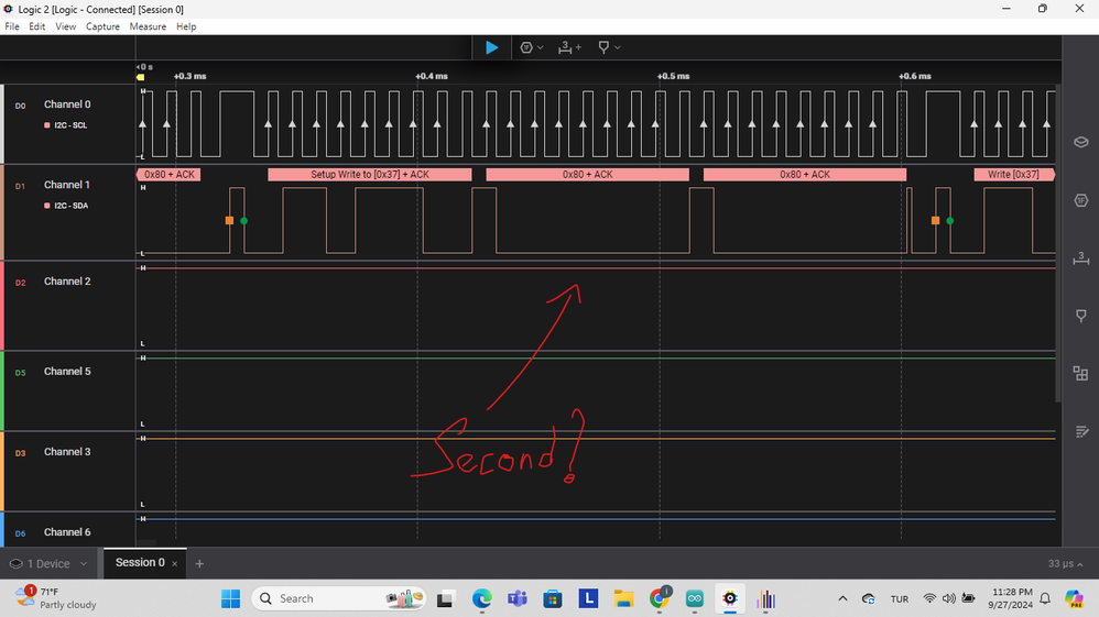

I’ve been dealing with an I2C protocol error for a long time, but unfortunately, neither the solutions online nor the suggestions here have been successful. I've changed sensors multiple times and tried different methods, but the problem remains the same. I’m using the STM32F413ZH board, and in my current tests, I’m using the QMC5883L model for I2C. The pull-up resistors are connected correctly. I even tried soldering the connections to improve them. I also attempted to supply power externally and change the cables, but the issue still wasn’t resolved.

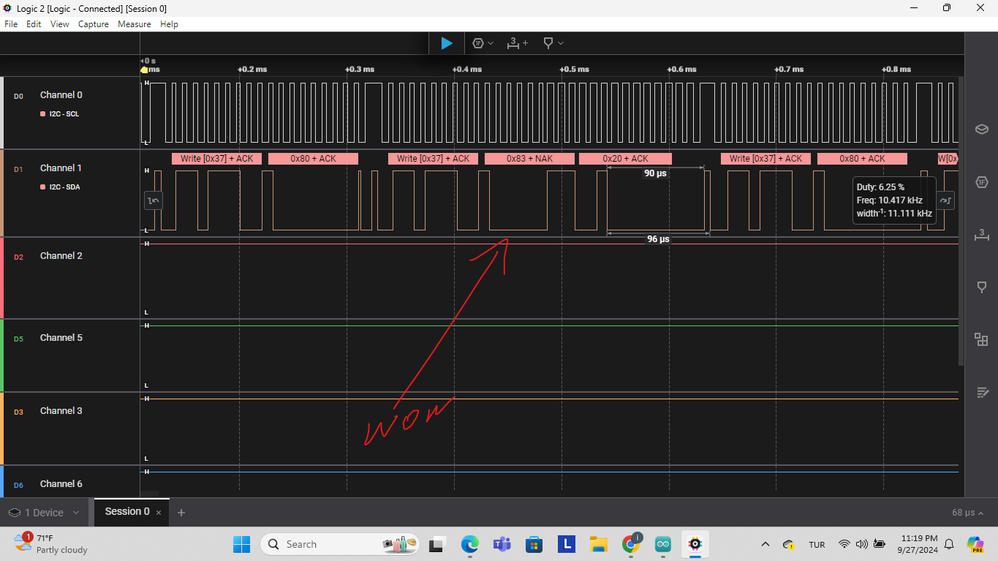

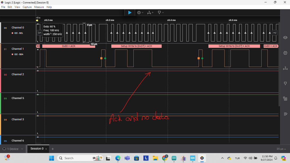

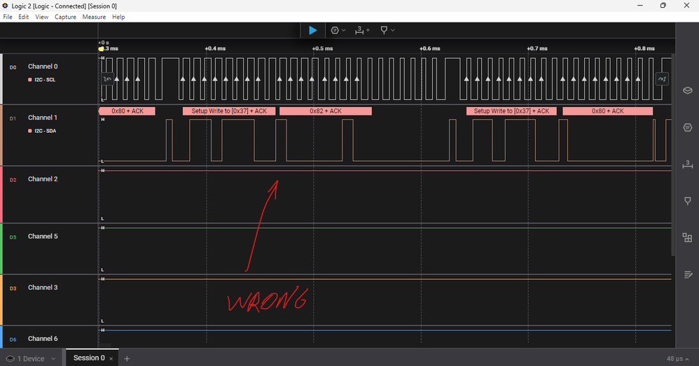

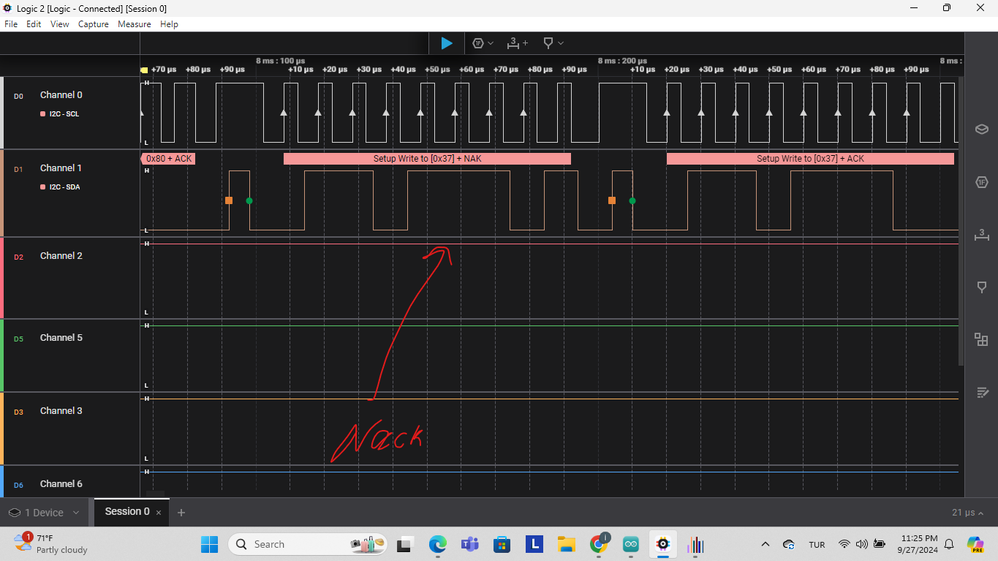

I used a logic analyzer to monitor the bus, and either the signal gets stuck as shown below, or it works chaotically in a meaningless way. For example, SCL often stays high, while SDA changes continuously, or SDA stops entirely at certain points and then continues later. I've seen many variations like this, but it rarely works correctly. I mostly get error codes like 32, 36, and 544.(So it comes as 32 + 512, and in the HAL definitions, 512 is defined as an error of incorrect initialization. To be honest, I have no idea why I’m receiving 512.) I’ve tried the solution involving 9 clock toggles, as many people suggested, but that didn’t help either. I suspected the issue was with the STM32, so I tried it with an Arduino, but although it worked, it stopped after 30-40 seconds. Whatever I do, I’ve never been able to achieve stable operation.
There have been rare instances where the STM32 managed to make a single read, but it would then break again as I described. However, this happened very infrequently. At this point, I’m really starting to think that STM32 engineers have failed in handling this issue effectively.
I will now provide a few examples from the logic analyzer, the current code I'm testing, the values read, and the products I'm using.
I would like to thank in advance everyone who takes the time out of their valuable schedule to assist me with this issue.
Signals captured within very short time intervals:

I am now certain that the problem is caused by the QMC sensor. In my tests, I successfully established I2C communication between Arduino-Arduino and STM32-Arduino, and the communication was flawless. As you mentioned, when I checked the resistors on the QMC, I saw that one was 2.2k and the other 0.3k. I then replaced it with a new QMC that had the correct resistors, but there was still an issue. (In fact, strangely, the device overheated and started smoking. This had happened to me before.) The connections were as follows:
* VCC-5V
* GND-GND
* SCL-SCL
* SDA-SDA
Although the overheating issue had occurred before, I still don't understand the reason behind it. As I initially mentioned, communication between Arduino-Arduino and STM32-Arduino was flawless, but sometimes the situation depicted in the image below occurred. Frankly, these are not major issues since they do not disrupt communication, and maybe these issues are due to the logic analyzer I used and its speed. Do you think such errors are normal?
Under normal conditions, the STM32 sends data 0x80 to the Arduino. The Arduino's address is 0x37.
