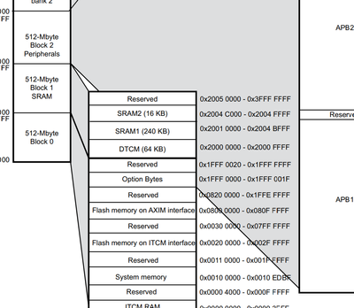

According to LWIP_IAP example, memory location 0x20048000 is labeled as ethernet rx buffer location; however, I could not find where this location is linked to the ethernet rx buffer. for example, 0x2007C000 memory location in the linker file for RxDescripSection & TxDecripSection. And does the size of the MPU region have to be equal to or greater than MEM_SIZE defined in opt.h?

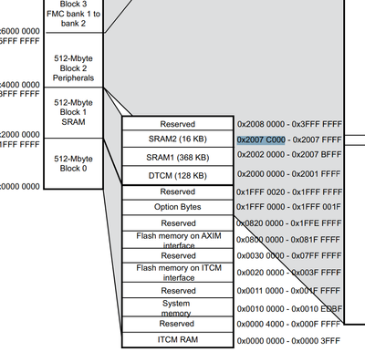

Hello @cleonb322 ,
based on the example LwIP_HTTP_Server_Netconn_RTOS your MPU configuration should be as follows as you are using an STM32F767 check RM0410

The MPU configuration you are using is valid for stm32f75xx and stm32f74xx check RM0385
