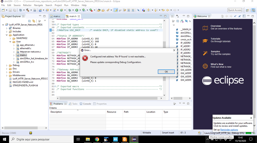

I´m trying run the the LwIP example in my board STM32F429ZI board. I following the steps:
1) In STM32CubeMX I selected the board STM32F429ZI and the example LwIP_HTTP_Server_Netconn_RTOS, using example selector. I export and import the project to a SW4STM32 workspace.
2) I can compile the project without error, but when I tryied run it I got the following error:
Configure inet adress 'Not IP fond' is not reachable
Please update correspondenting debug Configuration.
Did you get this error? Could you please, help me?
