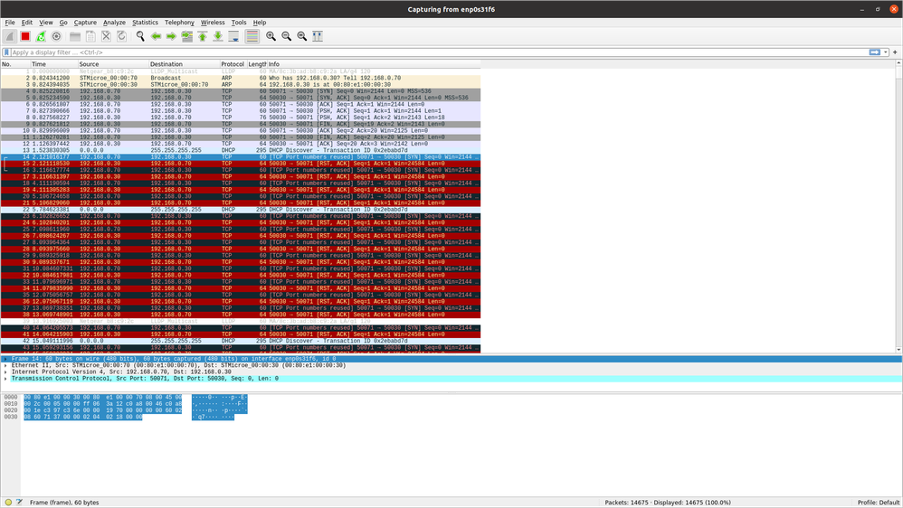

Hi All,
I have written simple TCP client using Netconn interface in LWIP on stm32f417 board. Client connects to LWIP server that is also on another stm32f417 board using Netconn api. After first succesfull TCP transmition, connection freezes, when connection with wireshark through switch that is mirroring port to PC I see ACK message from client after FIN ACK is sent from server. In some other workign TCP connection I see FIN ACK from server and then FIN ACK from client. So i think my client is should be not sending ACK message.
Question: Why is my client sending ACK message?
Thank You.
Peter
wireshark:
