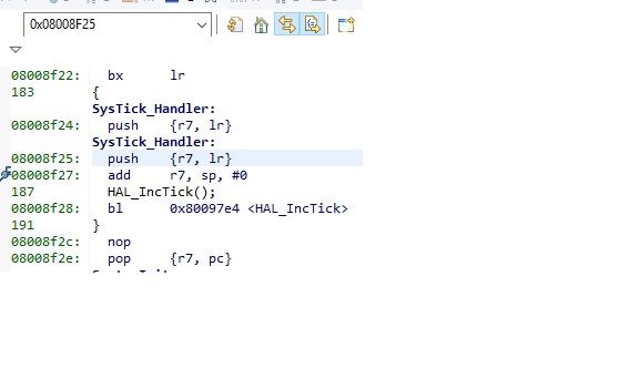

2020-06-24 4:53 AM
This values seem to be good.
when I look the flash memory address corresponding to the 0x0800803C content, it correspond to the systick_handler !
The problem isn't there.
The problem is that there isn't IT event raised !

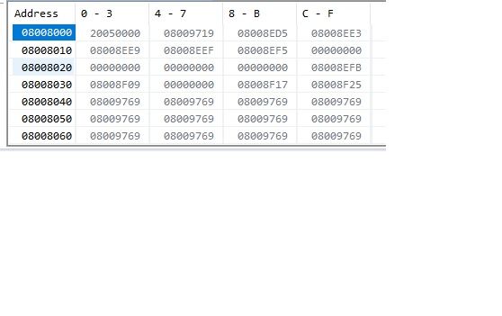

2020-06-24 5:00 AM
Sorry, if you don't tell the values, I can't help you any further.
2020-06-24 6:37 AM
OK
@0x0800803C contains 0x08008F25...
and this address location correspond to the systick_handler...
2020-06-24 6:44 AM
